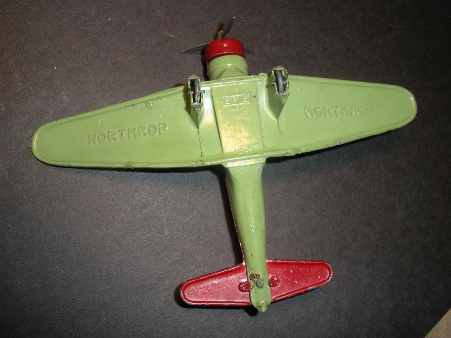

Good Morning All,
My son Luke (into 7th grade) spied this airplane at a Antique Mall yesterday. It looked nice enough to invest but when I got home my research was dismal. It is Erie and it is Northup. It seems complete but the few pictures that I have seen dipict these with a silver bottom and not pale green. The NC registration numbers on the wings appear to be carefully stamped on the wings. It looks intact and does not appear to be ever taken apart so the green appears to have been applied before final assembly
Any information would be appreciated.
Best Regards, Tom

Your son Luke has a superb eye. That is a very rare toy.
That is a totally original Northrop Alpha {or Gamma} by Erie, prewar, suberb condition and original registration and colors. The Gamma is a similar aircraft but had a bigger engine and other design difference
All of the Eries are rare but that one, two-tone painted, is in my experience, the rarest one.
All Erie aircraft date after 1936.
They also used the wing casting with a new top casting to make the Northrop Delta.
Also a smaller Lockheed Beta with twin open cockpits and a Boeing 247.
These aircraft were all red, two tone, silver, or chromed.
The Erie B-17, rather a YB-17 early protoype of it, had a changeable red or yellow nose and some variants had a wire frame for carrying the B-247 piggyback style.
There is a boxed set of all the aircraft and two vehicles, all chromed.

Postby Flyingtiger10 » Tue Jun 14, 2011 5:27 pm
HI Tom:
GR is correct in his comments.
The Gamma plane that you have is the rarest of the Erie series.
Your color scheme is quite common, though, but it seems to be
in great shape. It was sold with a cast three blade propeller as
yours, and stamping the registration numbers after the paint job
was typical.
The other color combinations are gray and red, blue and red and
yellow and red, harder to find. But the rarest is a red fuselage
and chromed wings, no registration markings.
The price quoted by GR is adequate, if you get the appropriate
interested collectors bidding on eBay.
Erie Metal Specialties, was a rogue manufacturer of diecast toys
from the mid-thirties,trying to compete with Tootsietoys.
It was created as a spinoff of the Parker casting company, of Erie, PA.
Unfortunately, after patent disputes with the Dowst Brothers of Chicago,
it was forced to close three years later. So, their toys are rare and
hard to find. As they are not well known, demand is low.
But casting is very precise, done to relative accurate scales, and
used the 'drip-method' paint job, with basic color paints available
at the time: silver, red, yellow, green, gray, blue and copper or
silver chrome finishes. This way, blobs of paint appear many times
that may look as a repaint, but that are factory originated.
The aircraft designs were chosen by the manager himself, based
on the advanced Northrop and Boeing models of the times. And
that would not conflict with Tootsietoy choices. But are the only
ones that have been cast by any toy manufacturer.
Hope this helps.
Jose Heraud.
