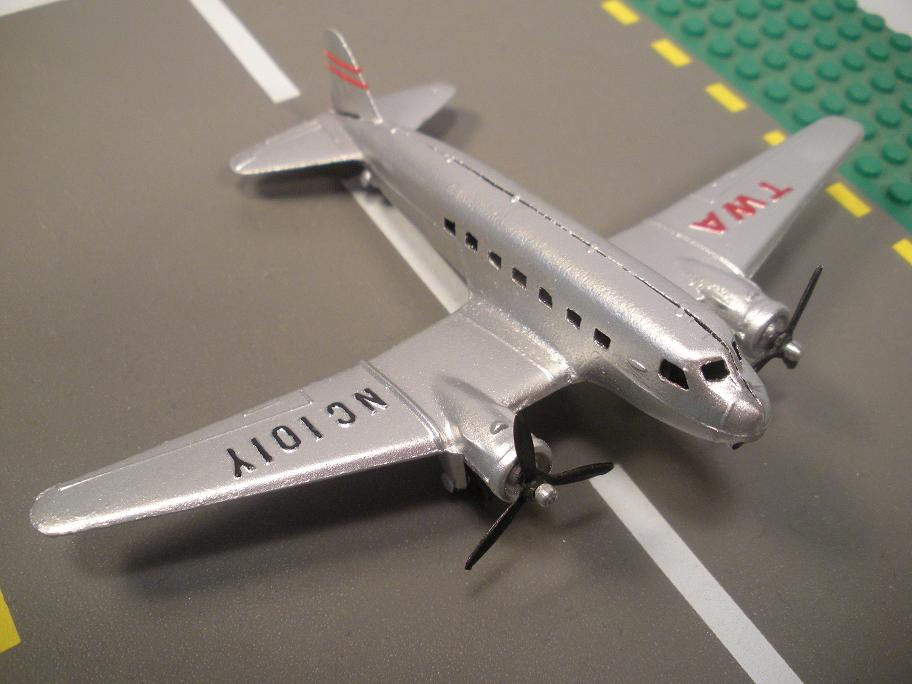

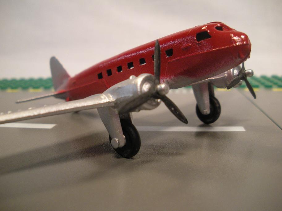

Postby sandmanoverhaul » Tue Feb 18, 2014 7:50 am
Michael,
On those Tootsietoy props...
1) To darken- use any flat or satin black paint, I have had good results using Testors.
2) The shafts are just nails and can be pulled out and the placed back in place. You can add some glue to the existing hole with a toothpick for extra insurance. Layer a piece of wax paper between the engine front and the back of the prop's hub area. Let the glue dry one day and then rip it away. Props should spin easily.
I have added shots of those new props installed. Both were for other collectors whom wanted aluminum bosses on the prop shafts.
