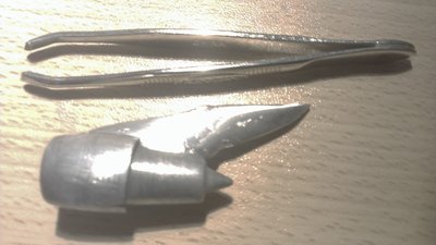

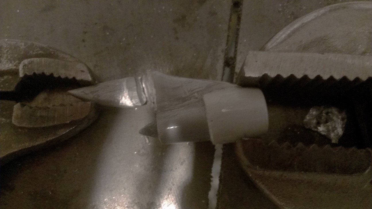

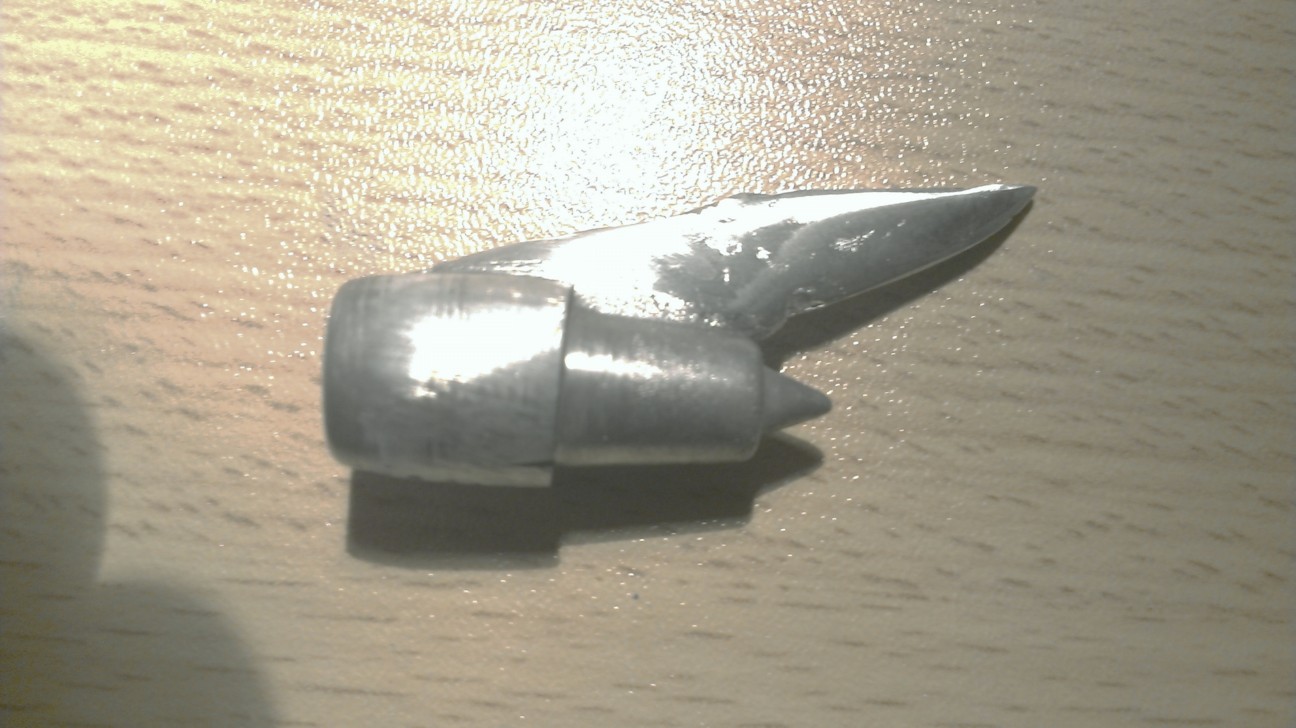

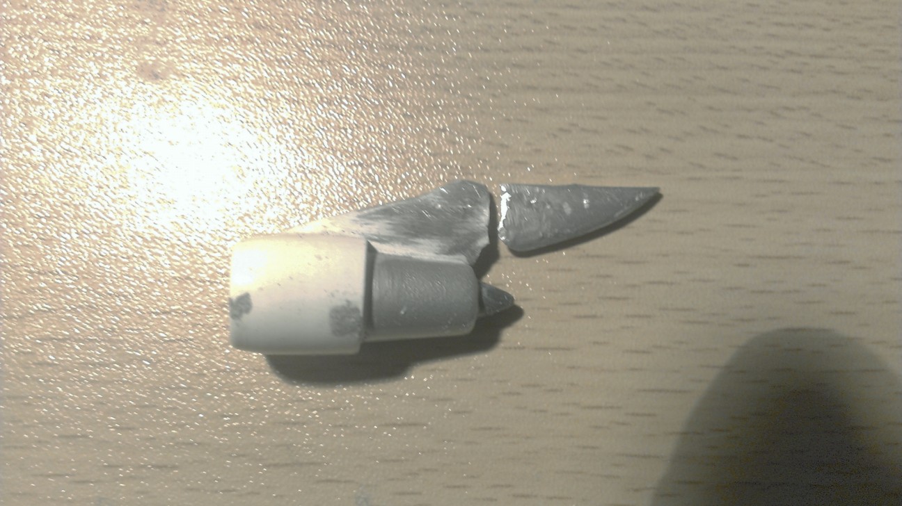

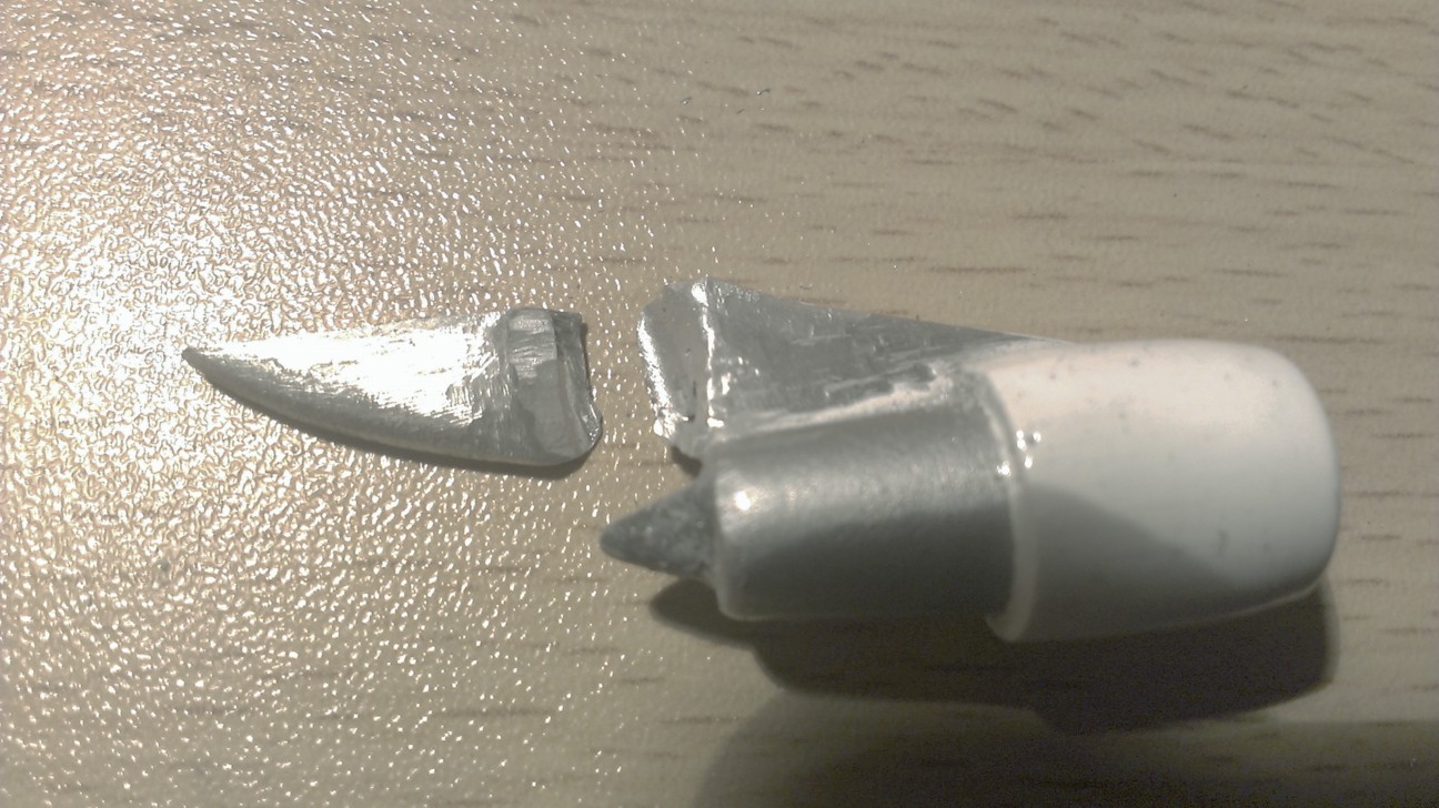

Here is a pic of one engine from an aluminum model that I got in the mail broken
I created a channel for the metal ti sit

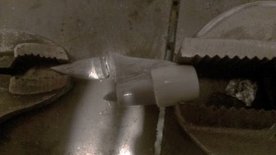

I Place each half in a pair of Vise-grips to hold in position
Re: What to do with broken props and engines
Postby voodoo1200 » Thu Mar 20, 2014 7:50 pm

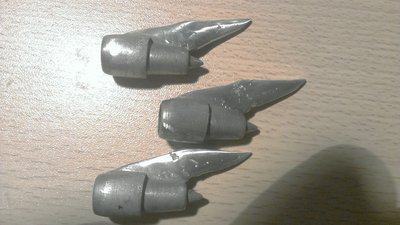

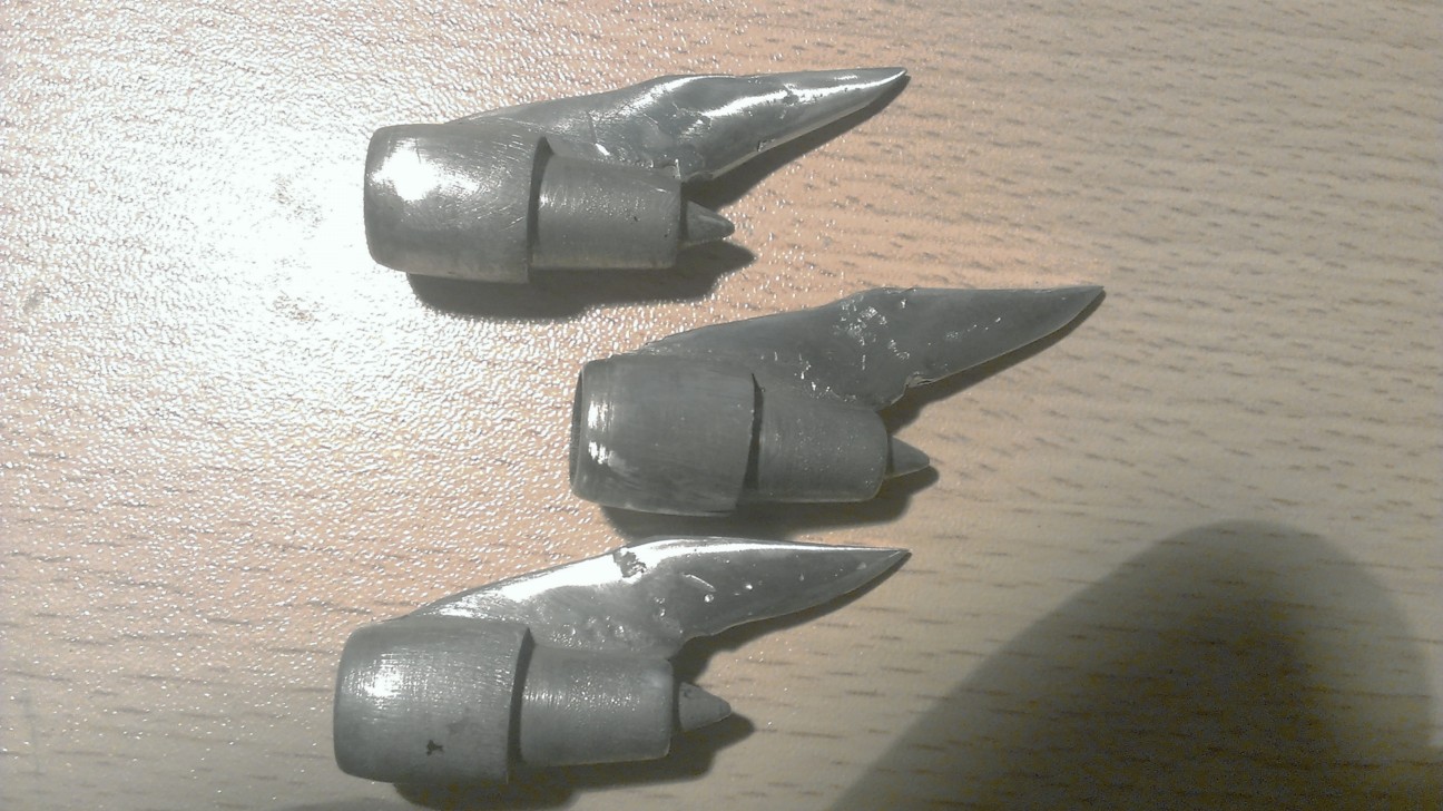

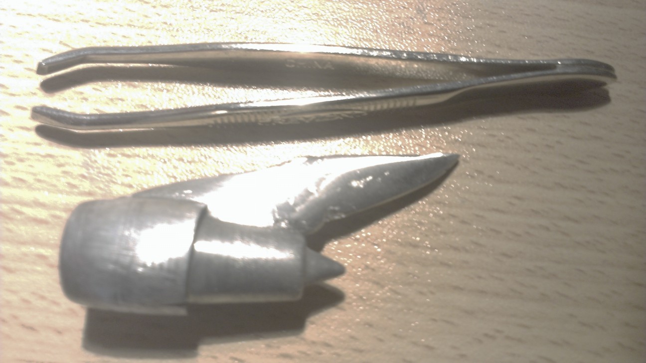

Once welded it's just a matte of removing excess weld material and shape the part
Here is the part after welding and filing away excess material
Comparison of the size of part I am working on
Three broken engines and pylons turn into tree new engines and pylons

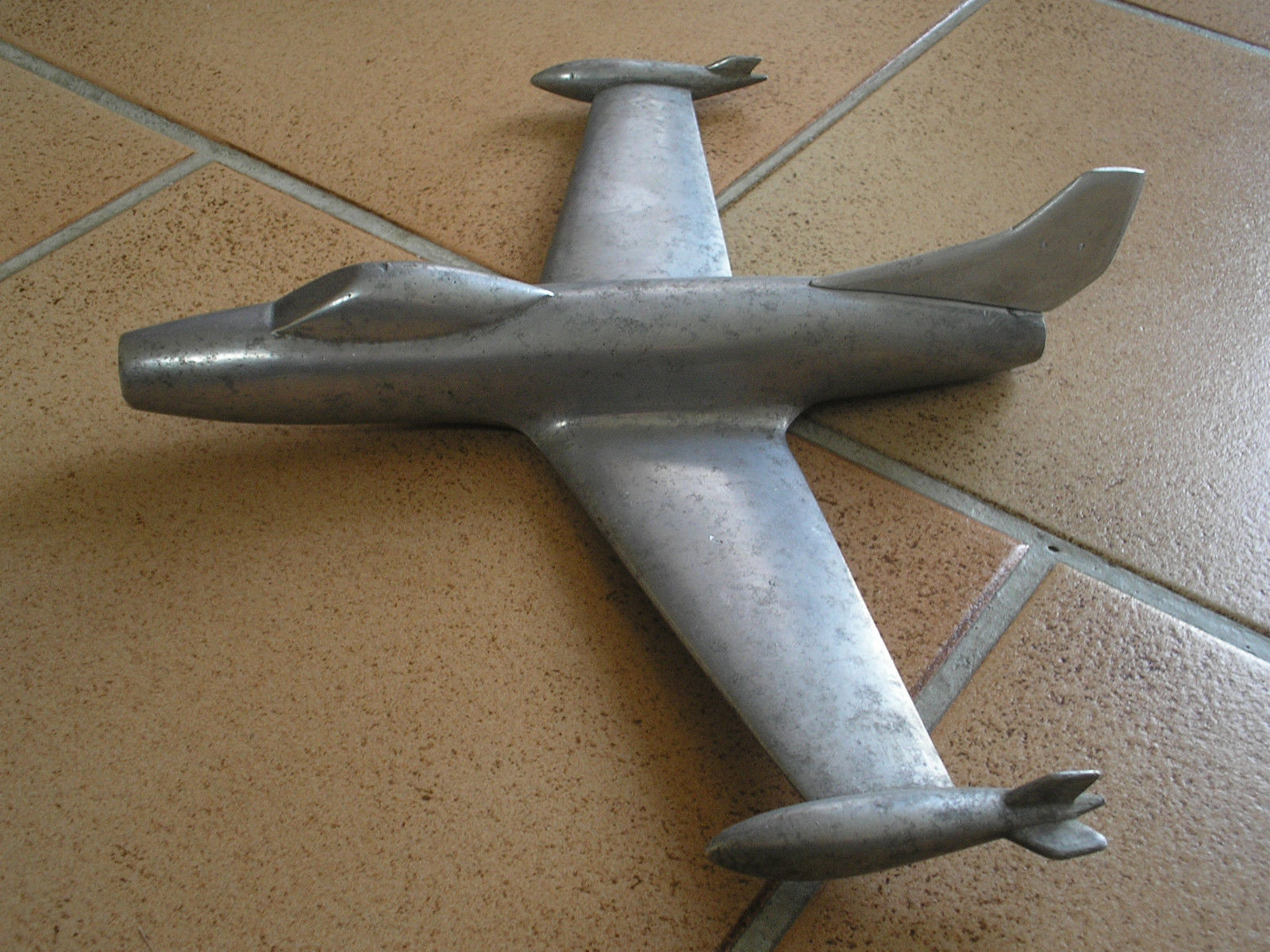

Here is an MD-190 Ourangan missing the tail and Horizontal stab.
MD-190 as I received it
Now with a new welded on tail and Horizontal stab

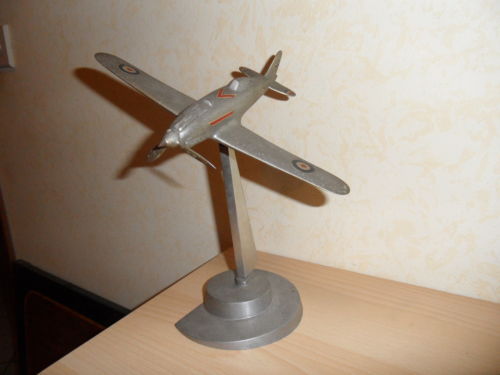

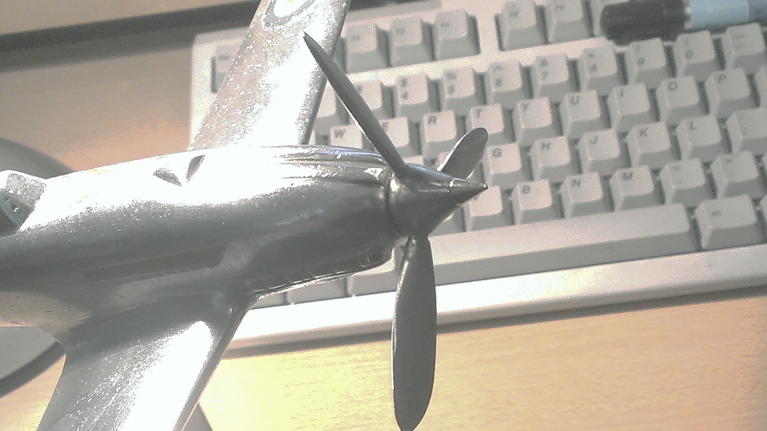

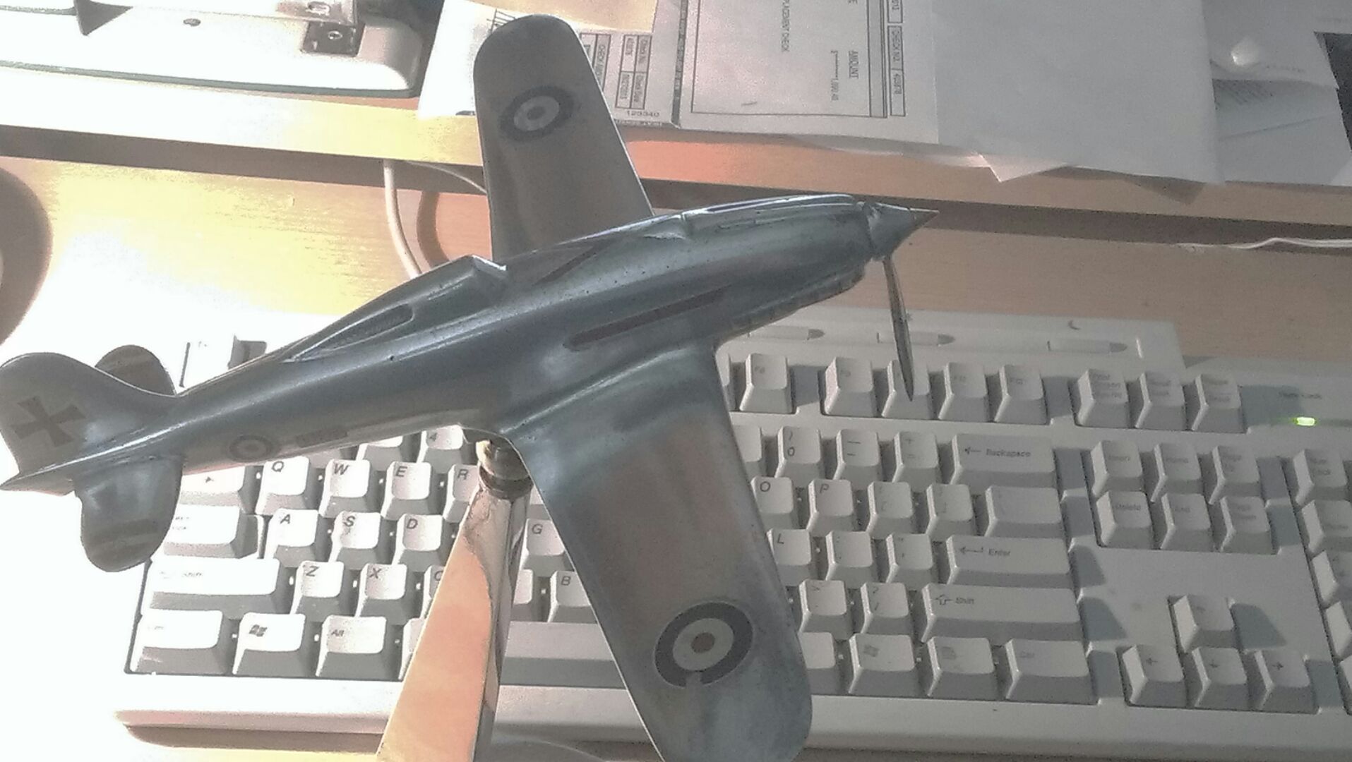

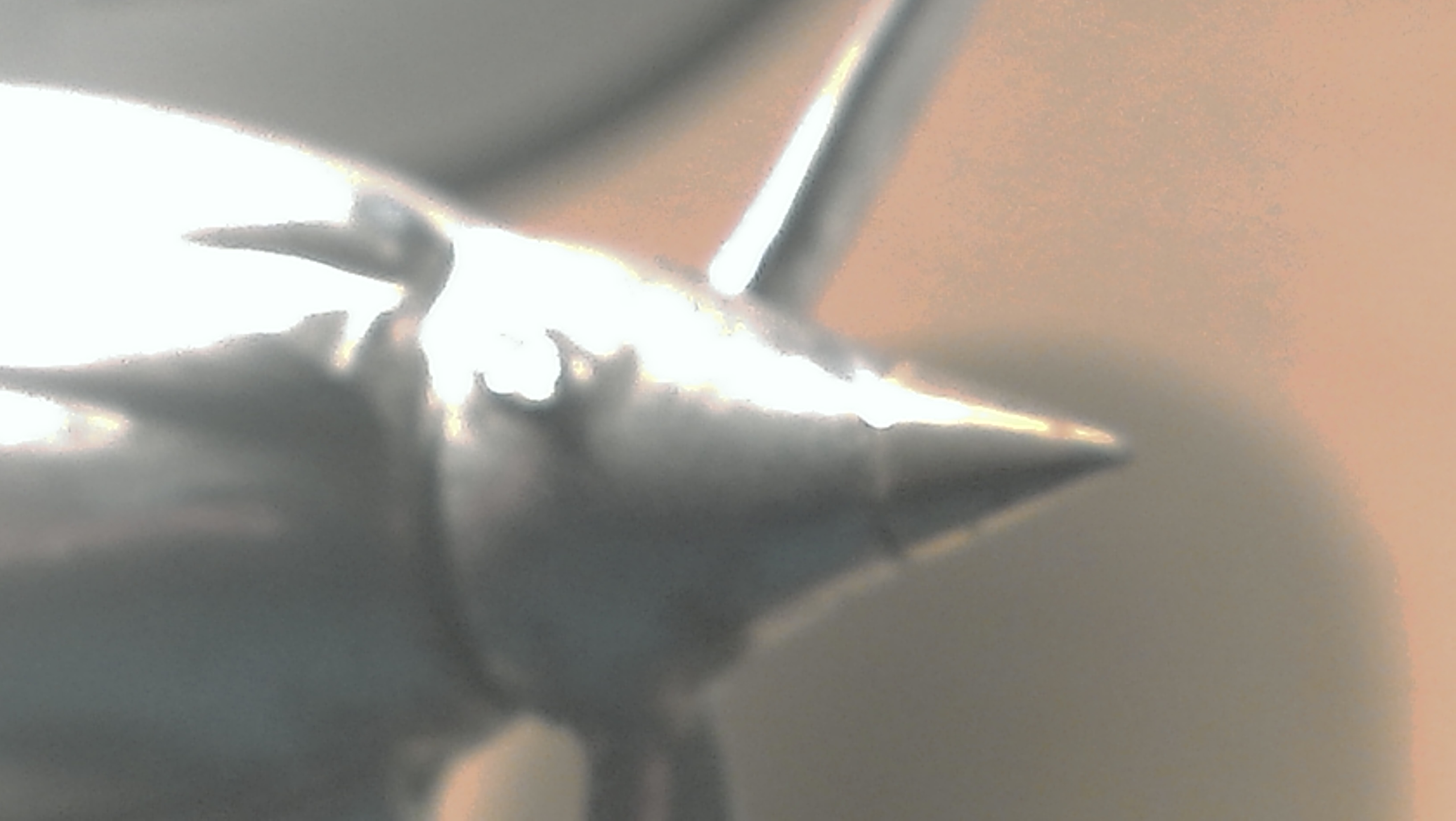

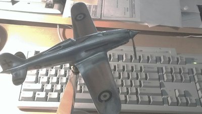

Here is an original Macchi 202 with a broken propeller blade
Pic of plane when I bought it with a little bit of polish
Close up of missing blade
original condition
Postby voodoo1200 » Thu Mar 20, 2014 8:03 pm

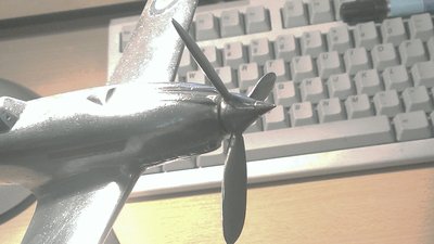

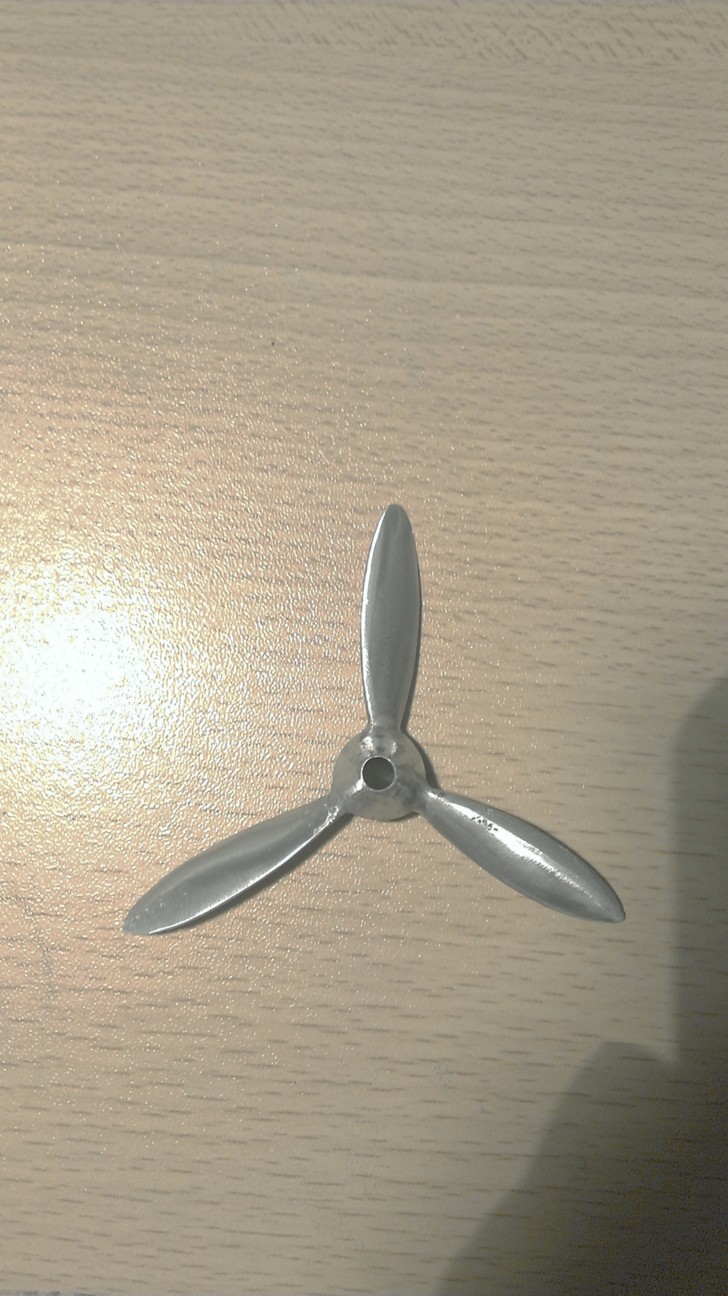

After cutting out the right shape in aluminum sheet, the blade weld welded into place and shaped with a file and sand paper.
after the blade was welded to the spinner
prop completed and back on the plane.

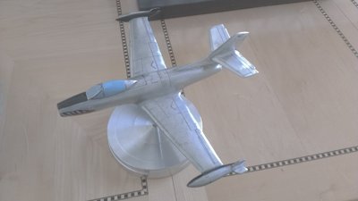

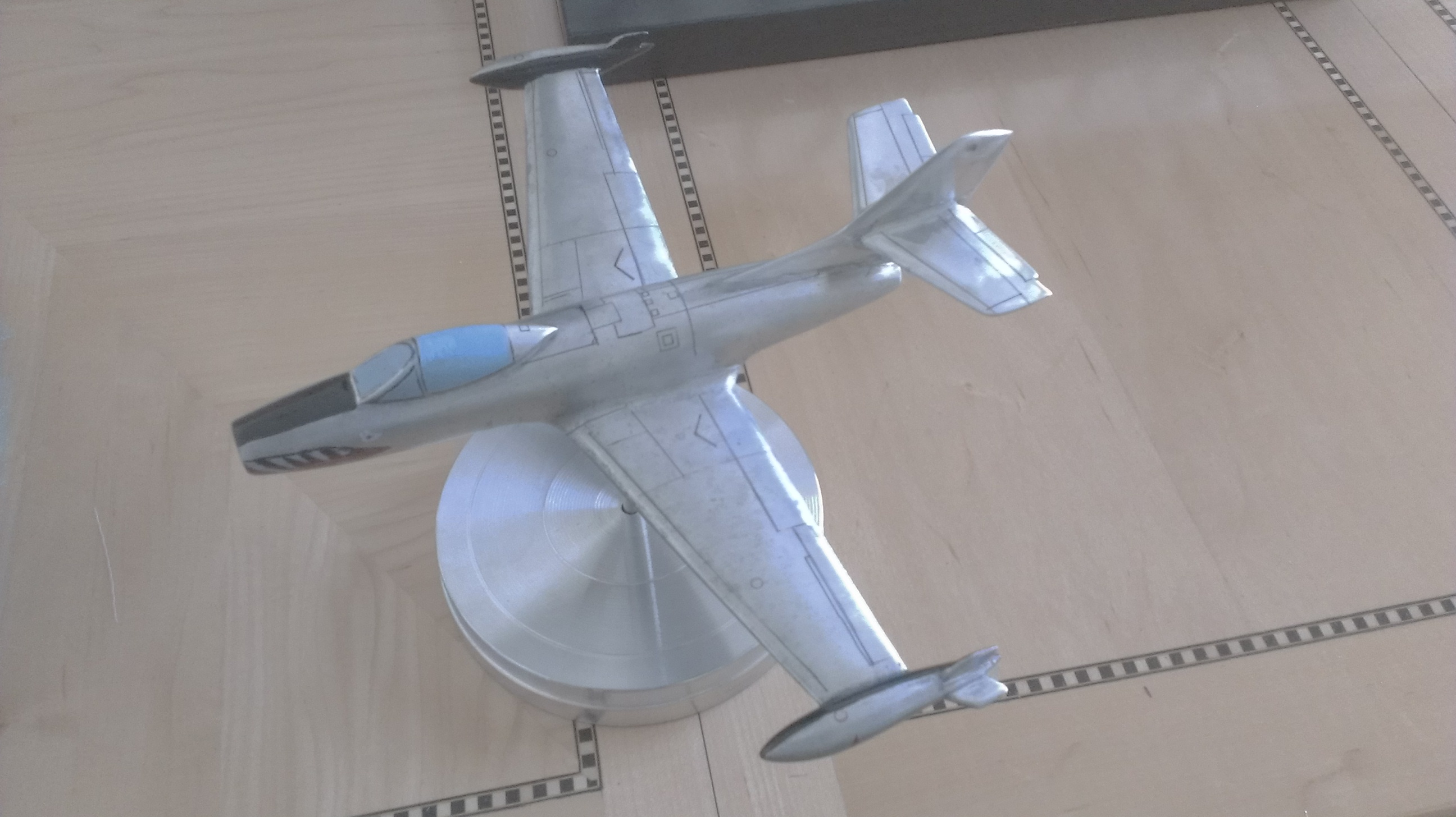

I actually broke the entire tail section off an all aluminum F-84F and successfully welded it back on......however I wasn't sure it was going to work so I didn't take before and after pics.
