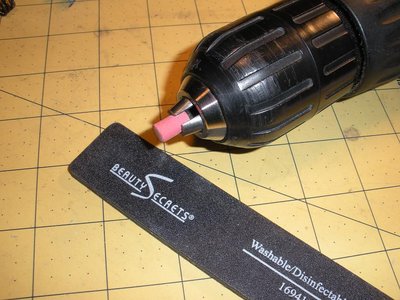

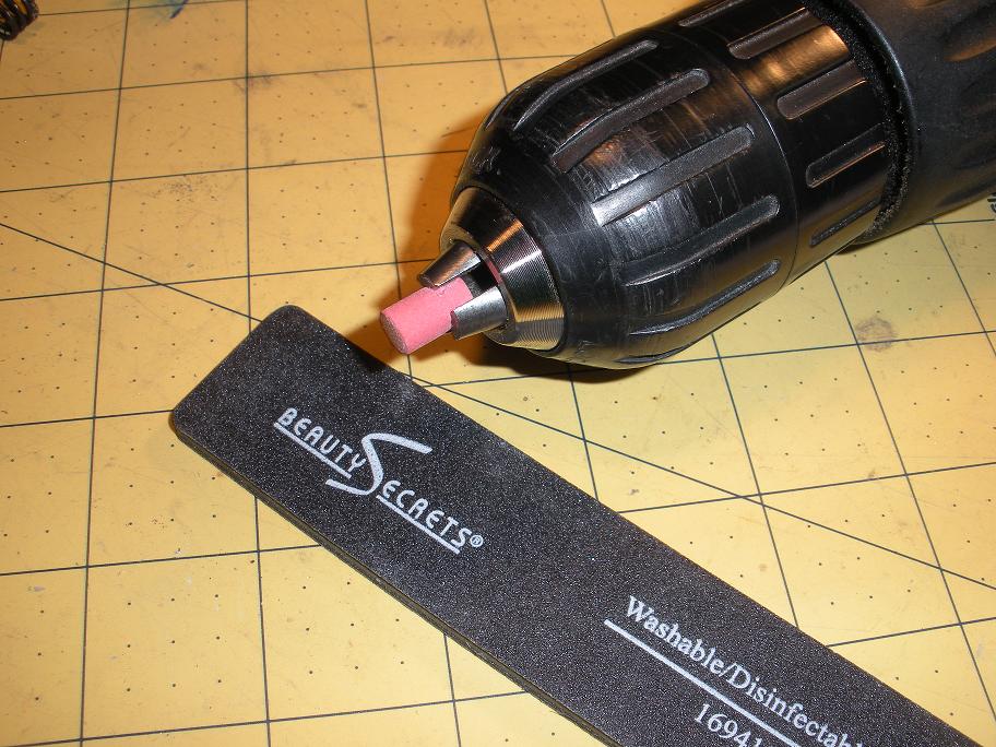

4) Pull out that new eraser from the pencil and chuck it into your drill. Grind off enough material such that the easer slides inside the spring. Do not cut off the excess yet.

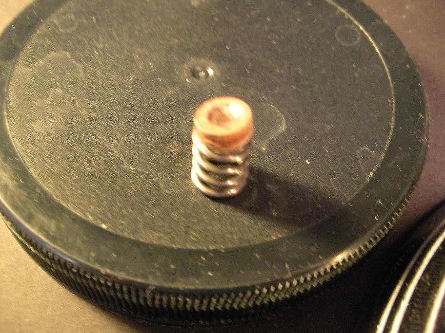

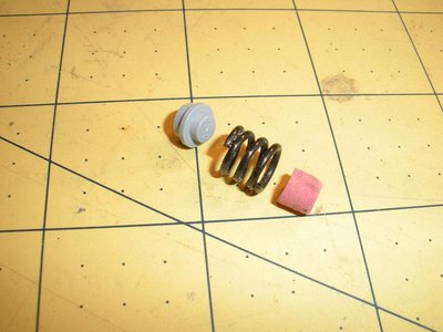

5) Locate the little Lego light "Lens" and glue with the male end in, into the spring and let dry over night.
6) Next day, slide the modified eraser into the inside of the spring until it makes contact with the Lego lens. Trim it flush on the bottom.
7) Simply reassemble as before and tighten the assembly so all is flush.
8) Done! If the airplane is too rigid for your liking, trim off 1mm or more off the eraser.

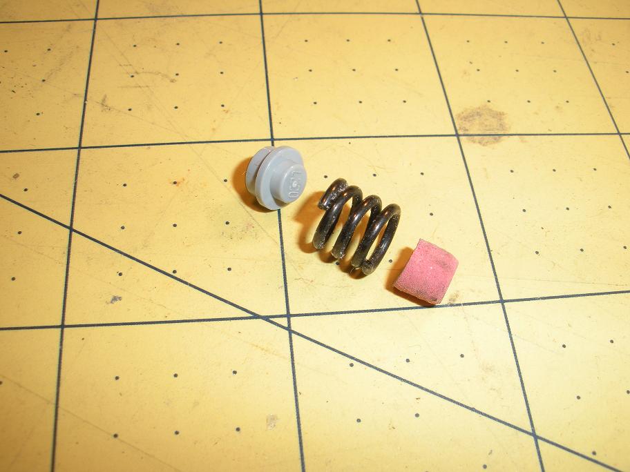

The first picture shows the original spring/pad assembly. It is the pad that is uusally missing causing the "Limp Model Syndrome"
The Next picture shows the pencil eraser ready to grind to fit into the spring.
The last picture shows the new assembly of parts- The Lego lens (grey piece), Allyn spring, modified eraser.
This whole assembly gets mounted with the Lego piece contacting the ball on top of the arm on the stand.

Original Pink/Red Friction Pad on Spring- This pad gets lost easily!
#1 Pencil Eraser ready to modify
Components that make up the new Assembly- Lego Lens, spring, easer plug
