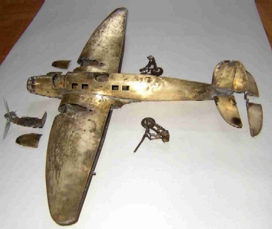

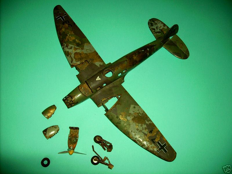

Postby fliegerii » Sun Mar 14, 2010 9:02 pm
A few months ago I got the pictured model of a Heinkel HE-111 B1. Span is about 45 cm, which makes a scale 1/50. As you can see, about 30% of the parts are missing. The model has moveable flaps, gears and gear doors. I was so far not able to clarify the origin of the model. It could be a Heinkel engineering model (Heinkel was deep in making such kind of models) or a prototype of a toy maker. The design of the gear is very close to Maerklin, but the most famous Maerklin expert here in Germany refuses it as Maerklin model. DUX could be another option.
The model is made of brass plate. I have started a while ago to complete it. I will not keep it in this condition, but fully restore it including all working functions. Target for completion is Christmas this year..... 8-)
The poor condition and the many missing parts makes it necessary to design some transmission and other parts by my own idea. Before I am entering the hot phase of work, I would like to know, if any of you have this model as well or know it. Actually I don't believe that, but one never knows... and it would be disappointing if I complete it partly on phantasy base and after finishing somebody sends me a photo of the original model....
So if you know something, please let me know!
Thanks for your support!
Chris

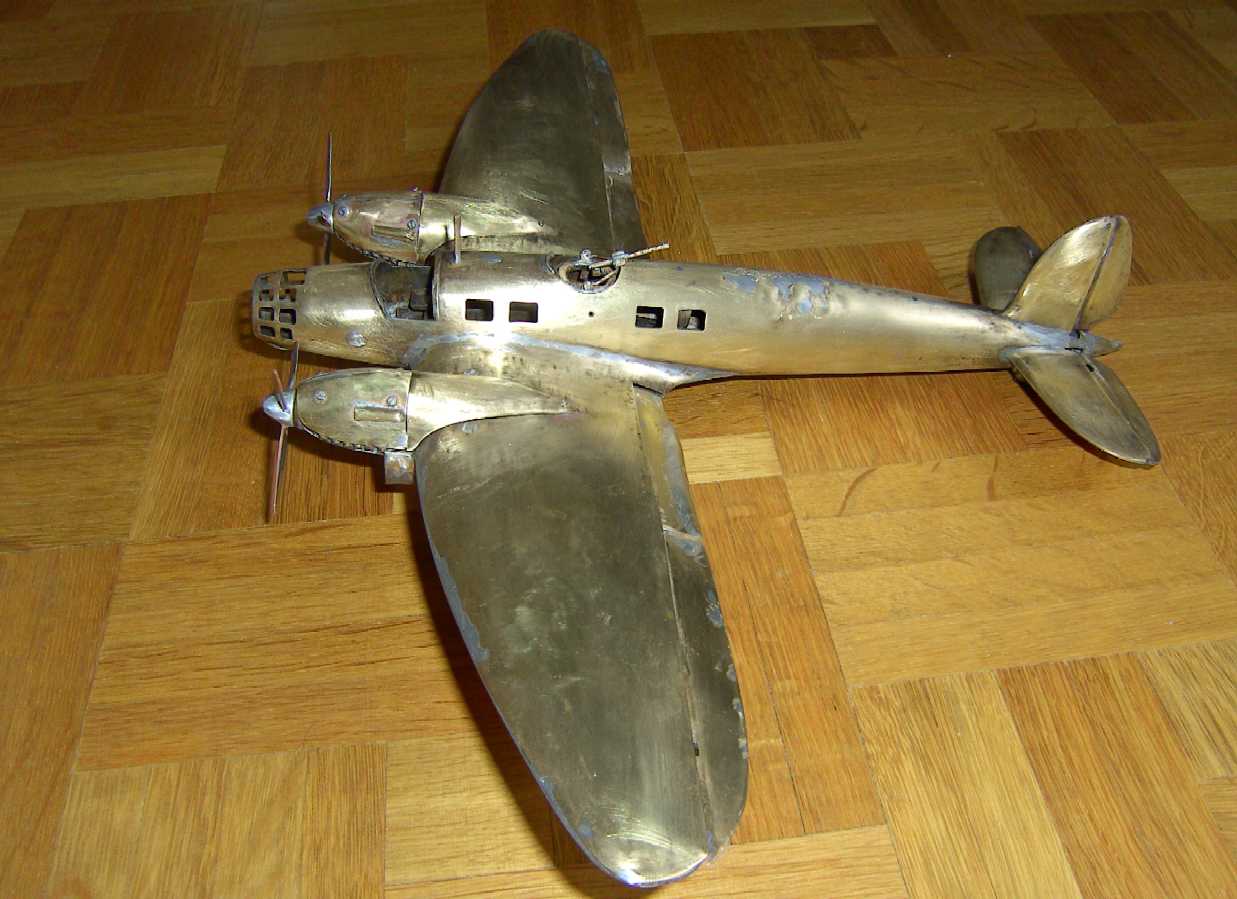

Postby fliegerii » Sat Apr 17, 2010 7:35 pm
Meanwhile the paint is stripped down.....
Re: Heinkel HE-111 B1
Postby fliegerii » Sat Apr 17, 2010 7:41 pm
.... and the main flaps are re-added, including the transmission gear being allocated in the wing.

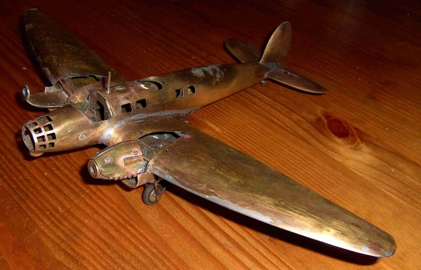

Postby fliegerii » Tue Sep 21, 2010 8:28 pm
The engine covers, the machine gun on top and a bottom plate is still missing, otherwise complete. Of course I still need to consider how to do the canopies.
The brass is difficult to photograph....
The plane is full of mechanic inside. Also that is not possible to catch.

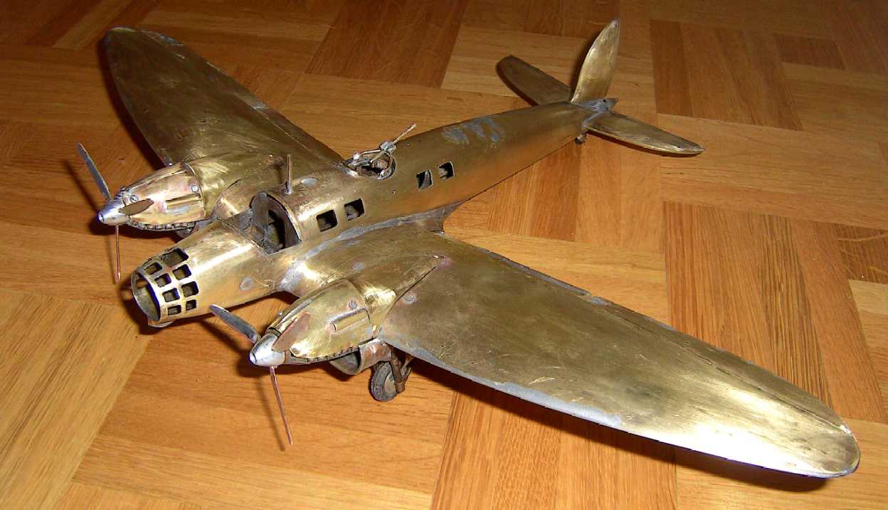

Here comes the last update in 2010:
- Engine cowlings completed
- MG 15 on B-stand added
- Props added
- Flaps accurately re-worked
- Bottom plate added (not visible on pics)
Next step is now finally the making of the canopies. I have decided to make a positive mould from resin and to use standard heated plexi to create it over the positive mould.
