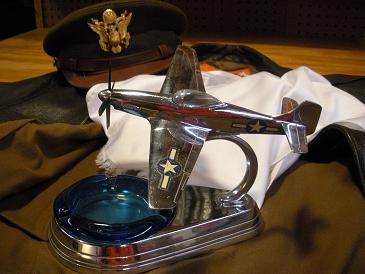

Postby soslipstream » Tue Jan 05, 2010 3:30 am
Hey all,
Here is my first of my "Airplane Ashtray" collection, an Allyn Sales P-51. It was found like most without canopy or prop blades. After conferring with Steve Remmington at Collectair, I made my own. The canopy shown is the MK1 mule. I will use it to build more but with a slightly lower profile. The prop blades are resin units that are modified to match each stub and are "cuffed" like the prototype's. The tips are awaiting a touch of yellow. I am blessed with two more of these ashtrays in the same condition and am now looking for one more.. leads are welcome.
Regards, Tom

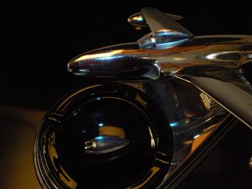

Postby BoeingDriver » Thu Jan 07, 2010 2:06 am
Try these shots. I can't get to the P-51 easily so I have to shoot it through glass. Hope one of these helps.
The prop on mine was already removed by the guy I bought it from. I hadn't even thought about it for years until you brought up this subject. Now I'll probably have to do something about it.

Re: Allyn Sales P-51 Ashtray
Postby soslipstream » Thu Jan 07, 2010 2:18 am
Ladd,
Great Shots, thanks!
