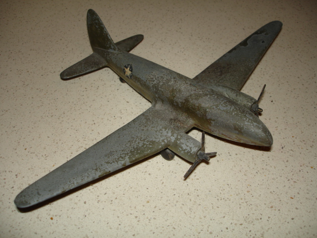

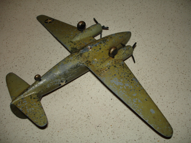

Here some of the desk models Bronzart made. At least I think so. I have a B-26 also but no pic.

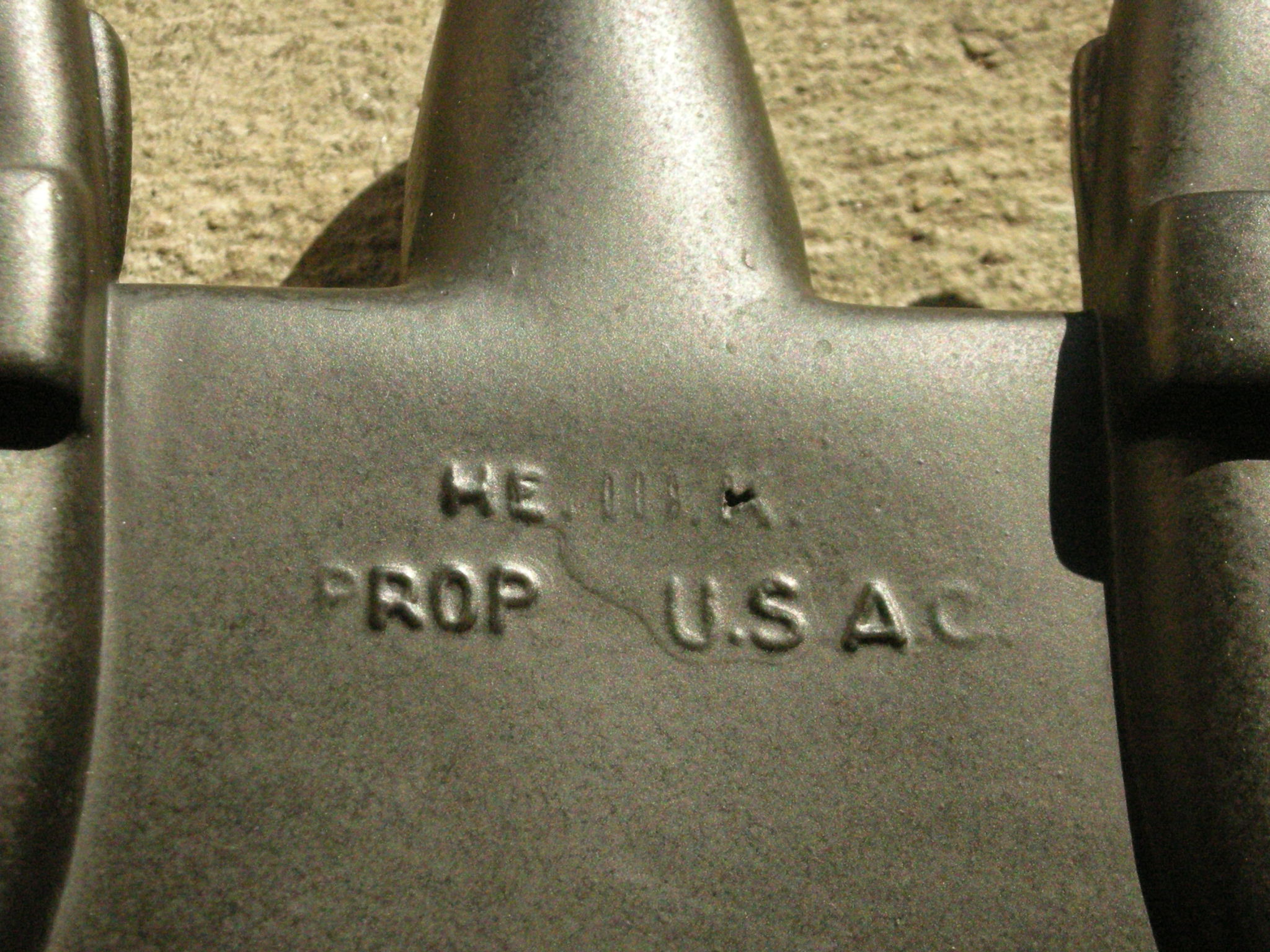

Hi GR -
Your HE-111 certainly looks like a Bronzart model to me. Markings are sometimes faint or difficult to read because the mold became partially filled in. Look at the markings on my model. Some letters you can read, while others you have to take on faith. I believe I can see "AC" on the bottom of yours, and more might be visible with better lighting or a change in viewing angles. Looks authentic to me from where I sit!

Postby fliegerii » Thu Oct 29, 2009 7:37 pm
This is a wonderful riddle solved. If you look very closely to GR's pic, you can even see the "HE III" lettering in the correct position! Great topic!

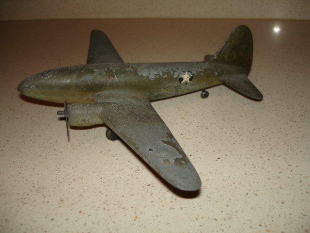

Postby car15 » Fri Oct 30, 2009 5:31 am
Is this a Bronzeart ID model?

Postby BWBrown » Sat Oct 31, 2009 12:29 am
This could be a model made by Bronzart, but it is probably not an ID model. Military training models were utilitarian devices, intended to be subjected to great abuse in the field. I have never seen a true military ID training model, regardless of construction medium, that had propellers. These were just too fragile and exposed to last in a training environment. New information about these old things surfaces every year, however, so I'd be happy to be proven wrong at some point. Based on today's knowledge of the genre, this is a model intended for some other purpose than military training. If you have more close-ups I'd love to see them! Thanks! - Bryan
