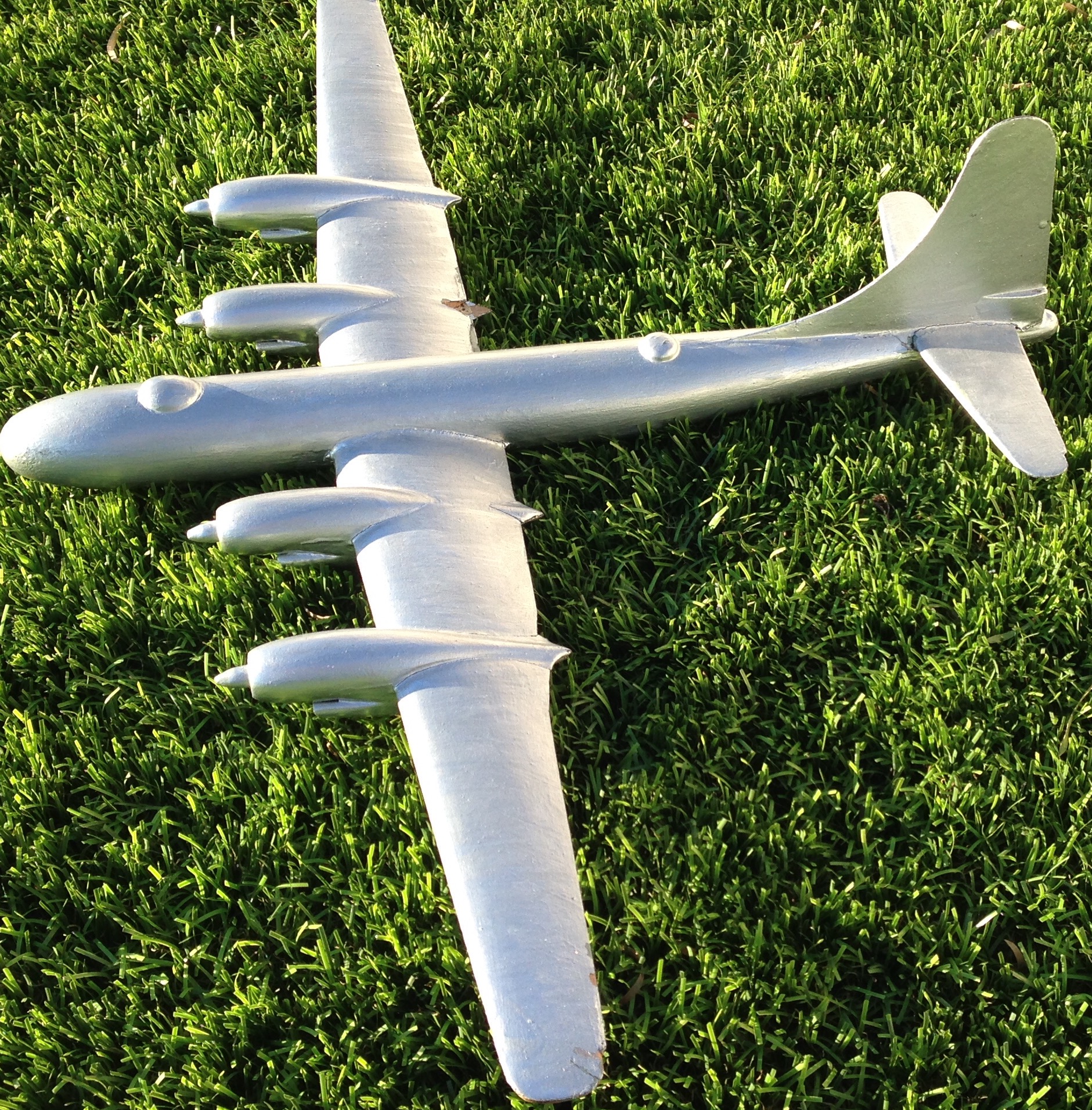

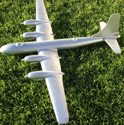

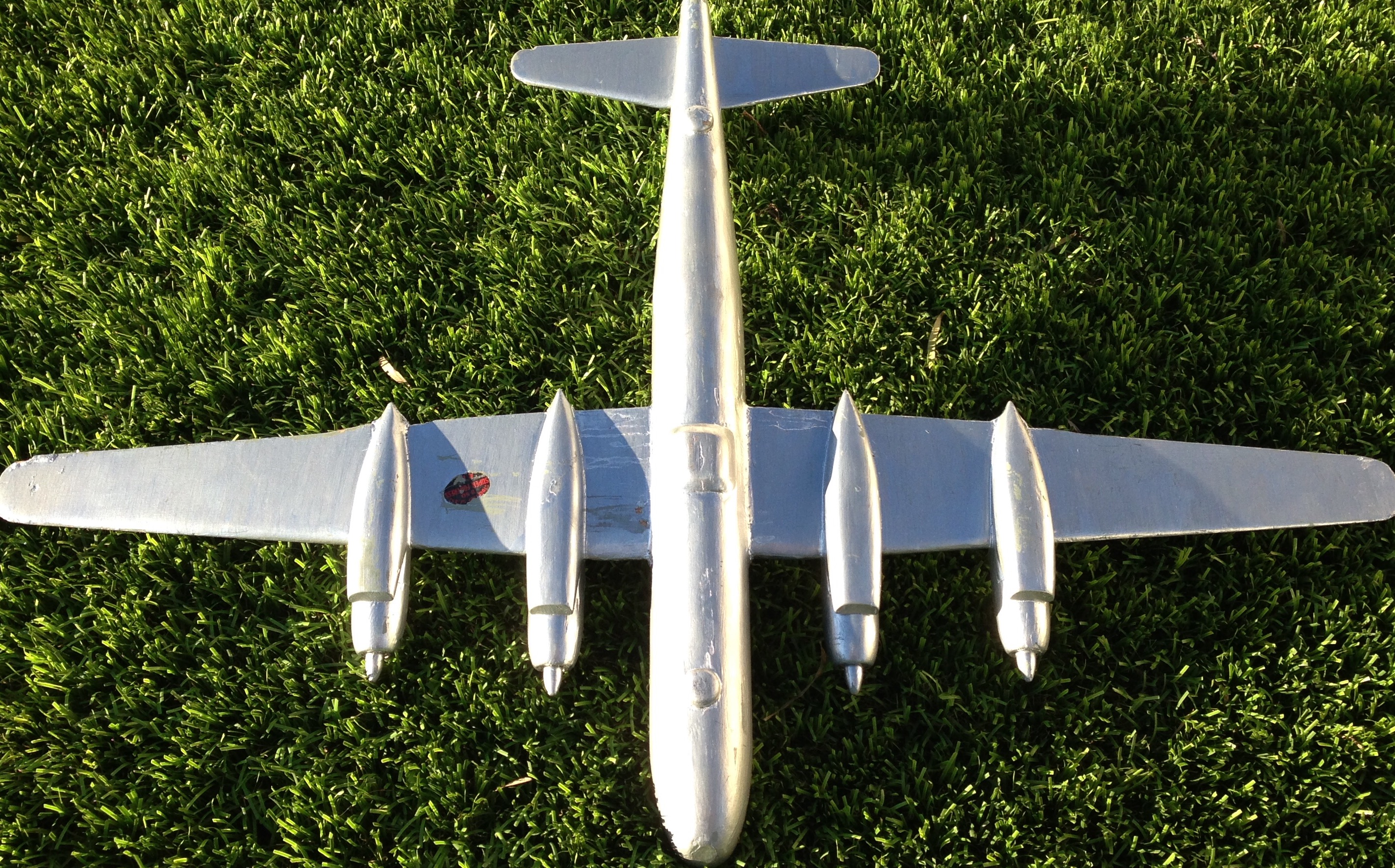

I picked up a British B-50 awhile back that had been painted in sloppy silver. I don't have any experience in any kind of stripping or painting... do any of you know if there's a way to restore it to its original paint underneath or is it best to Remove everything and start from scratch with a new coat?

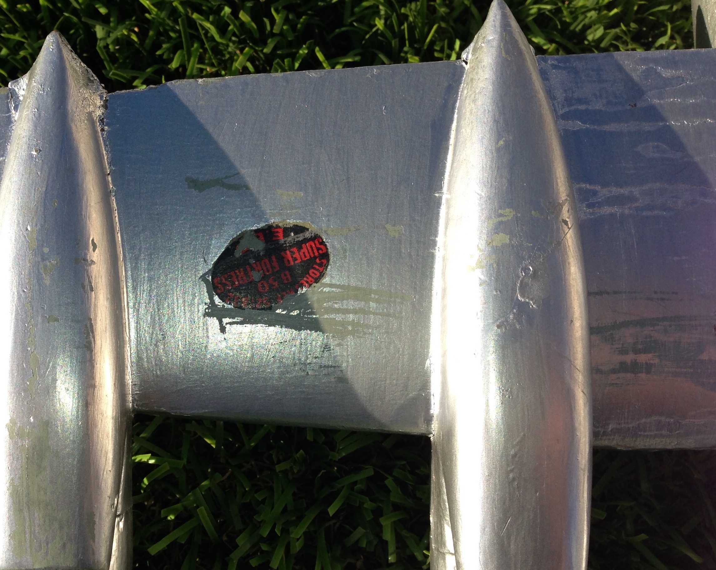

The model should be light sea gray when finished. You won't be able to remove the silver and get down to the original finish because it was just a thin coat to start with. You will end up with bare wood in some areas no matter how careful you are. Your best bet is probably to sand it some to remove surface blemishes and then repaint it over the silver. Just use MicroMask or something similar in order to mask off the little black/red label from the manufacturer if you want to preserve it. If you use tape you risk peeling off parts of the label. On the label you will see E.B.B., which initials stand for Earnshaw Bros. & Booth. They made your model. The other piece of information on the label is the RAF identification number, which is 52/832. The Royal Navy used a different nomenclature for their models.

I got lazy and let Bryan answer first, but totally agree with his recommendation to sand, etc. I would probably sand it enough (somewhere) that I could see the original paint color. I do not have one like this, but some of the EBB models are the green-ish gray color and some are black. You can certify that this one was originally the light sea gray (pretty sure this one was, but . . .) , and then can try to match any repaint to that color. I have found it hard to find a perfect match for the light sea gray, and had to experiment some when I was adding a missing vertical tail and did not want to disturb the rest of the model. Of course, I was dealing with an aged model that probably had faded some from its original color. Highly recommend you work to keep the EBB sticker. From a collector's standpoint, I will pay extra for an original label attached. Last, plenty of caution while sanding. Although easily repaired, parts do come loose or break. Be sure to take a photo and post once you finish! Good luck on your efforts!
