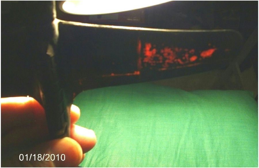

Question for the experts. I was cleaning some of my Cruver 1:72 models and washed off a Nakajima T97 NTB (Kate). When I held it up to the light, it was somewhat translucent with an amber look in a spot where there was some deformation. I could also faintly see an amber line on the wings where the aileron line would be. I bought the model 6 years ago, but had not noticed this before. It was starting to deteriorate (has not changed much if any over the last 6 years) and has the light vinegar smell. I have compared it to another Kate that has not deteriorated and the translucent one has shrunk and dried out some. I am pretty sure this is an original cruver model because I can not believe someone would mold and make one that showed damage, plus the typical smell is there.
Did Cruver produce the models in other than the black cellulose acetate and then paint some of them as the black models we are familiar with? I think I have seen clear models, but this one has a reddish amber look when you look through the wing. See photo.

The Kate model would appear to be a war-time model, but I am starting to have doubts. I had always assumed that you could identify a "true" Cruver from a recast by shaving/scratching a small amount of the cellulose acetate (or plastic from the recasts) from the hanging hole. When I did this for this model, I do not get the typical black residue, but a non-black plastic-like substance. And the translucent amber color can also be seen in the horizontal and vertical stabilizers which leads me to believe the entire model would be translucent if I wanted to remove all the paint. I did NOT notice the vinegar smell today (I have kept this plane away from any other Cruvers for several days). I am leaning towards this being a recast, but it is deformed/shrunk like the old Cruvers do. Guess someone made a recast from whatever they had and then painted it black? Odd to make one from a degraded model, though. Dennis

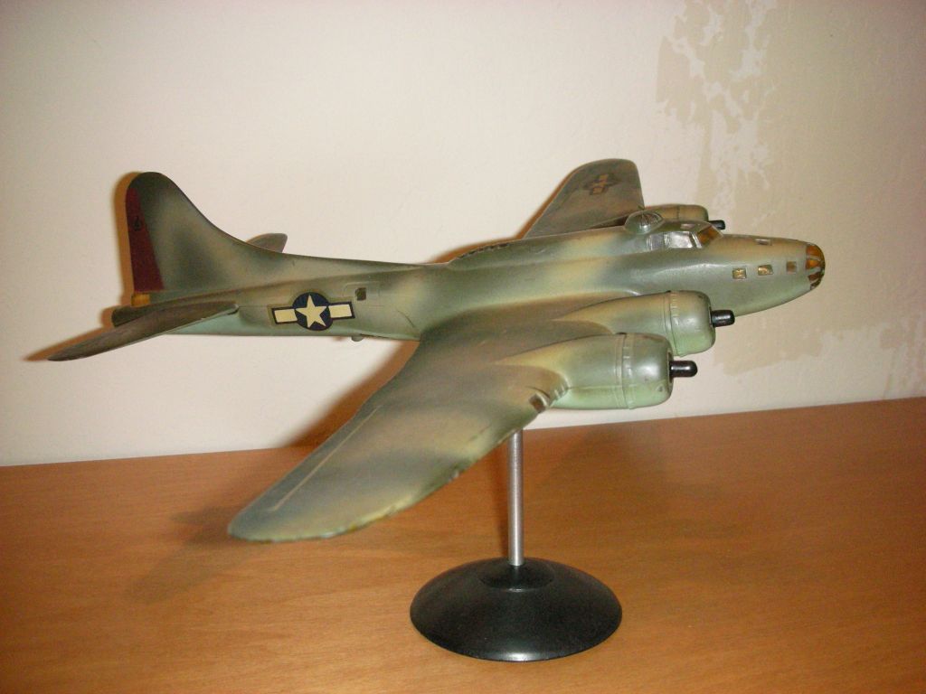

Yes! Thank you for that information...and that B-17 is lovely! Did you restore it, or is that still original?

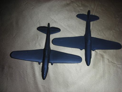

Postby BWBrown » Sun Jan 31, 2010 10:40 pm

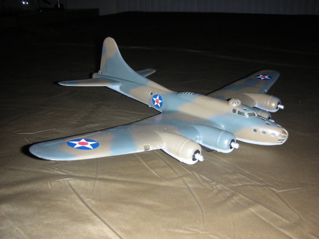

That particular B-17 I sent out for a professional restoration. It was in pretty bad shape when I got it. Then I found a different one. Pictures follow. This one has not been restored. They seem to have been done at different times because of the change in the national insignia. Also, the paint scheme is slightly different, with the red rudder and the black prop hubs.

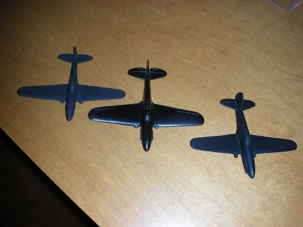

With respect to the P-40E vs. the P-40F, the difference that is most immediately apparent is the protruding "knees" on the E model. The radiator inlet is different, as is the top of the cowling, where the E model has an intake that the F model is lacking. First photo shows the E on the left and the F on the right.
This photo compares the F-N-E models, from left to right.
